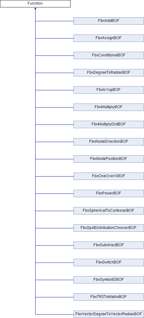

FbxBindingOperator::Function Class Reference
#include <fbxbindingoperator.h>
It represents a binding relationship between current object and the target.
Any binding operation need to specify a certain kind of binding function.

Implemented in FbxSpotDistributionChooserBOF, FbxSymbolIDBOF, FbxIsYupBOF, FbxSphericalToCartesianBOF, FbxVectorDegreeToVectorRadianBOF, FbxDegreeToRadianBOF, FbxPowerBOF, FbxOneOverXBOF, FbxMultiplyDistBOF, FbxMultiplyBOF, FbxSubstractBOF, FbxAddBOF, FbxTRSToMatrixBOF, FbxSwitchBOF, FbxConditionalBOF, FbxAssignBOF, FbxNodeDirectionBOF, and FbxNodePositionBOF.
