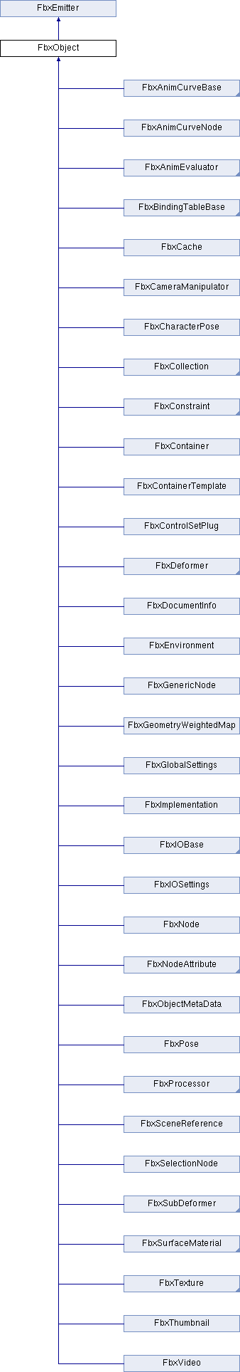

 Inheritance diagram for FbxObject:Public Types | |
| typedef FbxEmitter | ParentClass |
