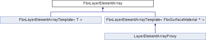

+ Inheritance diagram for FbxLayerElementArray:
