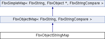

#include <fbxmap.h>
A class that maps strings to objects with a basic string comparator.
 Inheritance diagram for FbxObjectStringMap:Public Member Functions | |
