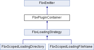

Inheritance diagram for FbxPluginContainer:Public Types | |
