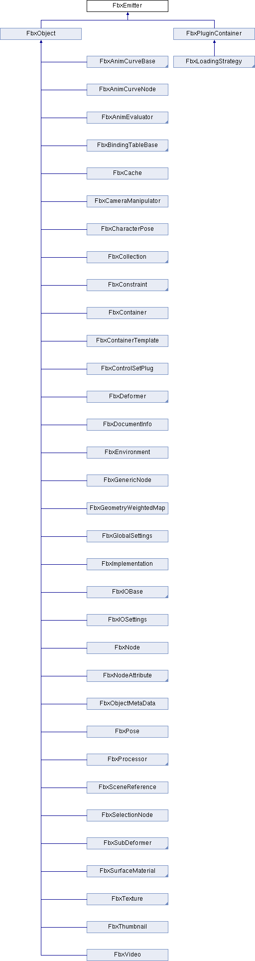

 Inheritance diagram for FbxEmitter:Public Member Functions | |
