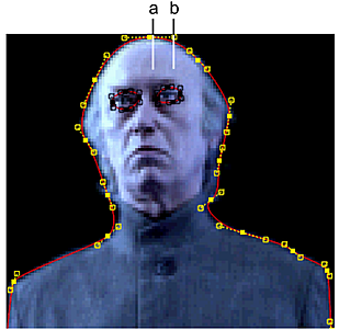

    (a) Vertex  (b) Tangent  
    Image courtesy of Behavior Communications Inc.
