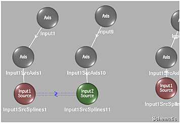

You also use the schematic to link Front1 and Front2 source splines to create morphs using source interpolation. See Linking Source Nodes.

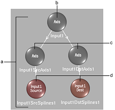

When you add a spline to the Front1 clip, for example, the following spline node tree appears.
(a) Spline node tree representing corresponding splines added to Front1 (Input1)  (b) Axis node for an Front1 (Input1) spline: the parent of corresponding source and destination splines  (c) Axis nodes for each spline  (d) Spline nodes for corresponding source and destination splines added to Front1 (Input1)  
Each spline added to an input clip results in its own spline node tree in the schematic, with its own corresponding source and destination splines.

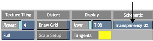

To set the transparency of the Distort schematic:
  1. In the Distort menu, click Setup.
  2. In the Setup menu Schematic section, adjust the value in the Transparency field.
    Note: The schematic transparency has a maximum value of 90%.
