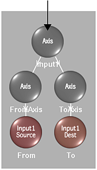

A spline node tree for a pair of corresponding splines on the Front1 (Input1) clip, and a spline node tree for a pair of corresponding splines on the Front2 (Input2) clip

Initially when you add a spline, its source and destination node is parented to its own Axis node, and these Axis nodes are in turn parented to a common Axis node. So, for example, you can control the position of a particular Front1 source spline via its Axis node. Click the Axis node, the direct parent of the Spline node, then use the Axis menu in the Distort tool to apply tracking data to the node.
If you want to affect both a source spline and its corresponding destination spline, you can use the Axis node at the top of the spline node tree.
When you add splines, they are initially parented to their own spline node tree. You can, however, add more Axis nodes to the schematic, and parent splines from different spline node trees to the same Axis node. This can be useful, for example, if you create splines for the different features of an actor's face and want them to move in tandem with the actor.
Axis nodes for corresponding splines can be unlinked from each other by selecting a spline's axis node, then selecting Enable Warping from the Link box.
