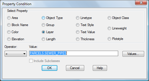

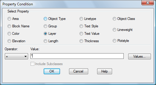

  4. In the Property Condition dialog box, do the following:
    • Under Select Property, select Layer.
      Select Layer as the property condition. Only objects on the layers you specify are added to the map.
    • Click Values.
  5. In the Select dialog box, select the PARCELS and SEWER_PIPES layers. Click OK.
  6. In the Property Condition dialog box, under Value, make sure that the two layers you selected are listed. Click OK.
    Specify which layers to use to determine the objects that are added.
