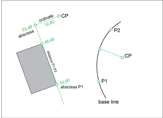

Use the Orthogonal Calculation function for orthogonal surveying. The base element is represented by either an existing line or by using two points which can lie aside. When the calculation is performed, measured and calculated dimensions are taken into account.
Orthogonal calculation elements
