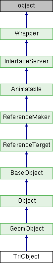

A triangle mesh object. All geometric objects should be able to be converted to TriObjects.
