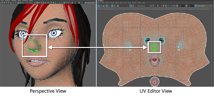

The UV Editor lets you view and interactively edit the UV texture coordinates for polygon, NURBS, and subdivision surfaces within a 2D view. You can access it from either or the UV > UV Editor menu in the Modeling menu set. For more information on how UV shells are used, see the related topics below.

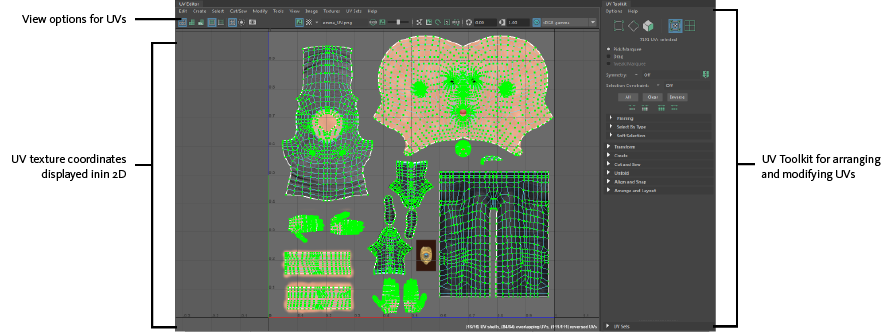

All major UV tasks are accessible within the UV Editor either via the UV Editor's menus, View bar, or UV Toolkit. Additionally, many functions are available outside the editor via the Modeling menu set's UV menu.
For a list of UV Editor menu items, see UV Editor Menu bar.
The View bar contains options for changing the display of the UV Shells in the UV Editor and occasionally the Viewport.

By default, the UV Toolkit appears on the right side of the UV Editor and contains all the tools you need to modify UV arrangements. For tools and commands with additional options, you can Shift + click the button to open the appropriate options window. You can also right-click certain options for alternate functions.
