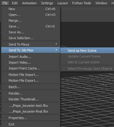

  5. Go to the main menu bar and choose File Send To 3ds Max Send as New Scene.
    The established connection between is indicated in the Viewer window Status bar ( ).

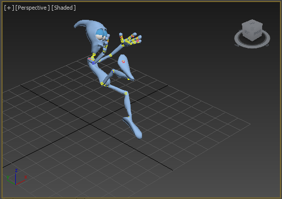

    The MotionBuilder scene loads into 3ds Max.
  6. Click Play in the 3ds Max Animation Controls to view the edited MotionBuilder animation.
    Pepe's animation is played back in 3ds Max
