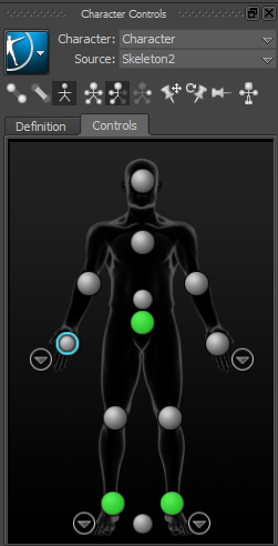

- In the Character Controls window, on the Character representation, select the Right Wrist effector.
Character representation Right Wrist effector selected
An effector that is selected is displayed with a blue (
) contour.

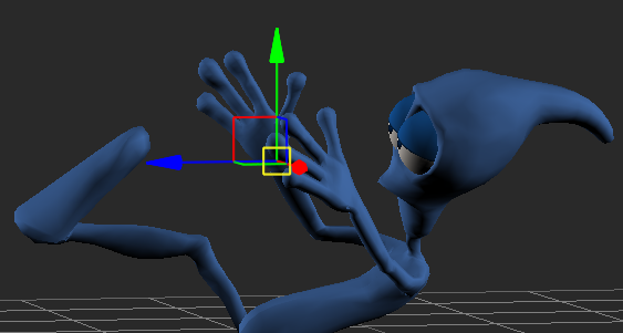

- Go to frame 95, the mid point between the two keyframes you set.
- In the Viewer window, move the right hand away from Pepe's face on its X and Z axes as shown in the following figure, then set another key.

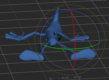

- Advance to the last frame of the animation and adjust your view so you can clearly see the position of Pepe's right hand and left hand.
Pepe's right hand does not rest flat on the ground.
- In the Viewer window toolbar to the right, click the Rotate tool (
) or press R to enable rotation.
- Modify Pepe’s right hand rotation until it rests flat on the ground, then set another key.
- Press R to use the key rotation rings to modify the hand’s position until it rests flat on the ground, then set another key.
