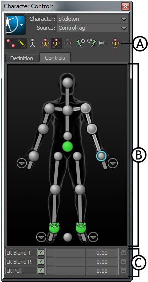

Controls tab A. Toolbar B. Character representation C. Blend and Pull controls
