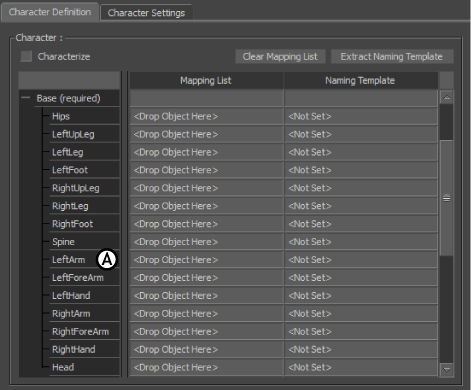

The Base group of slots let you define the basic set of bones that are required for any skeleton loaded into MotionBuilder. Map objects into this group of slots in order for MotionBuilder to understand the structure of your character model and its skeleton.
Base group of (required) objects in the Mapping List
Refer to the following table for a description of each slot in the Base group. See Bone naming conventions to view a simple skeleton illustrating the placement of these bones.
| Base slot | Description |
| Hips | The joint or bone that drives the hips of your model. |
| LeftUpLeg/RightUpLeg | The joint or bone that drives the upper left/upper right leg of your model. The LeftUpLeg/RightUpLeg joint or bone must be the child of the Hips joint or bone. |
| LeftLeg/RightLeg | The joint or bone that drives the left/right knee of your model. The LeftLeg/RightLeg joint or bone must be the child of the LeftUpLeg/RightUpLeg joint or bone. |
| LeftFoot/RightFoot | The joint or bone that drives the left/right foot of your model. The LeftFoot/RightFoot joint or bone must be the child of the LeftLeg/RightLeg joint or bone. |
| Spine | The joint or bone that specifies the chest of the destination skeleton. You can use this slot with the optional Spine slots for characters with a spine. Do not position the Spine joint or bone in the same position as the hips or poor mapping might result. |
| LeftArm/RightArm | The joint or bone that drives the left/right arm of your model. The LeftArm/RightArm joint or bone must be the child of the Spine joint or bone. |
| LeftForeArm/RightForeArm | The joint or bone that drives the left/right elbow of your model. The LeftForeArm/RightForeArm joint or bone must be child of the LeftArm/RightArm joint or bone. |
| LeftHand/RightHand | The joint or bone that drives the left/right hand of your model. The LeftHand/RightHand joint or bone must be the child of the LeftForeArm/RightForeArm joint or bone. |
| Head | The joint or bone that drives the head of your model. The Head joint or bone must be the child of the Spine joint or bone. |

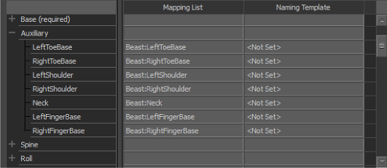

Auxiliary group of slots in the Mapping List
The following table describes each slot in the Auxiliary group.
| Auxiliary slot | Description |
| LeftToeBase/RightToeBase | The joint or bone that drives the left/right toes of your model. This joint or bone must be the child of the LeftFoot/RightFoot joint or bone. |
| LeftShoulder/RightShoulder | The joint or bone that drives the left/right shoulder of your model. This joint or bone must be the child of the Spine joint or bone, and must be the parent of the LeftArm/RightArm joint or bone. |
| Neck | The joint or bone that drives the neck of your model. This joint or bone must be the child of the Spine joint or bone, and must be the parent of the Head joint or bone. |
| LeftFingerBase/RightFingerBase | The joints or bones that drive the left/right fingers of your model. This joint or bone must be the child of the finger base. |

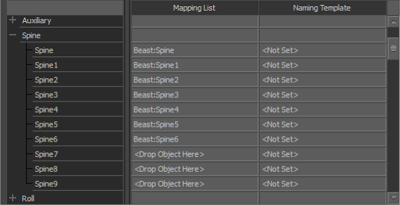

Spine group

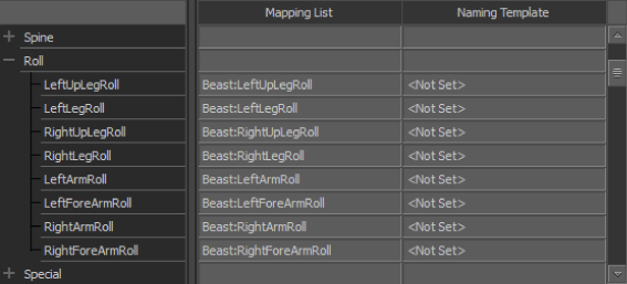

Roll group
When you create your model skeleton, it is recommended to add roll bones to the skeleton structure. Roll bones let you achieve more realistic envelope deformations by specifying a percentage of the roll axis movement on specific bones (see Modifiers in the Character Settings > Modifiers group of options.).
To transfer the roll properly, your bones or joints must be arranged as described in the following table:
| Roll slot | Description |
| LeftUpLegRoll/RightUpLegRoll | The joint or bone that rolls the LeftUpLeg/RightUpLeg. The LeftUpLegRoll/RightUpLegRoll joint or bone must be the child of the LeftUpLeg/RightUpLeg joint or bone. |
| LeftLegRoll/RightLegRoll | The joint or bone that rolls the LeftLeg/RightLeg. The LeftLegRoll/RightLegRoll bone or joint must be the child of the LeftLeg/RightLeg joint or bone. |
| LeftArmRoll/RightArmRoll | The joint or bone that rolls the LeftArm/RightArm. The LeftArmRoll/RightArmRoll joint or bone must be the child of the LeftArm/RightArm joint or bone. |
| LeftForeArmRoll/RightForeArmRoll | The joint or bone that rolls the LeftForeArm/RightForeArm. The LeftForeArmRoll/RightForeArmRoll bone or joint must be the child of the LeftForeArm/RightForeArm joint or bone. |

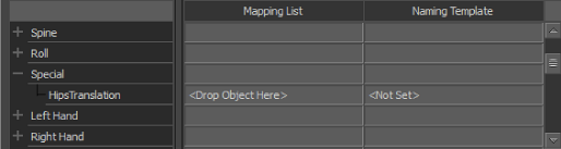

Depending on your model skeleton and the amount of control you want over your animation, you might want to split translation and rotation of the hips between two different joints or bones.
Special group with Hips Translation slot
The object defined in the Hips Translation slot should be a child of the Reference object in your character.
If you choose not to define an object in the Hips Translation slot, both translation and rotation data are sent to the object defined in the Hips slot. See Hips Translation Mode.
You can also select the method used to transfer rotation and translation to the Hips Translation and Hips objects using the Hips Translation Mode option in the Character Solving properties.

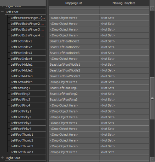

The slots in the Left Foot and Right Foot groups let you define the feet of your model and add realistic foot and toe movements to your character. To use these slots, your model skeleton must have feet with toes.
The Foot groups follow the same naming conventions as the Hand groups, so they contain slots for the thumb (big toe), index (second toe), middle (third toe), ring (fourth toe), and pinky (baby toe), as well as slots for an extra toe.
Left Foot group of slots
The number of each group of slots corresponds with each toe joint. For example, slots numbered with a “1” correspond to the toe’s first joint while slots numbered with a “4” correspond to the last joint of the toe. Each last joint or bone of the toe should be mapped to an end slot to define toe tips properly.
See Defining toe behavior for more information.

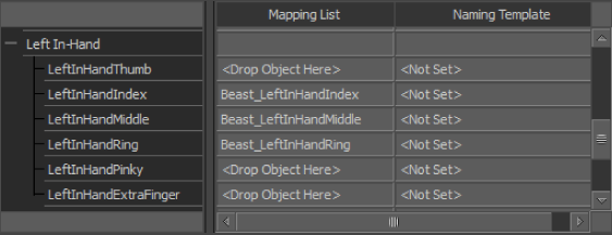

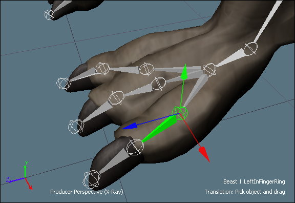

Left In-Hand group
Model with left In-Hand bones
The Left In-Hand and Right In-Hand groups contain in-hand slots for each finger (thumb, the index, middle, ring, and pinky), as well as a slot for an extra finger.
Each Left In-Hand/Right In-Hand object must be between the LeftFingerBase/RightFingerBase object and the first joint or bone of each finger. For example, the LeftInRing object must be the child of the LeftFingerBase object. The LeftInRing object must parent the LeftHandRing1 object.

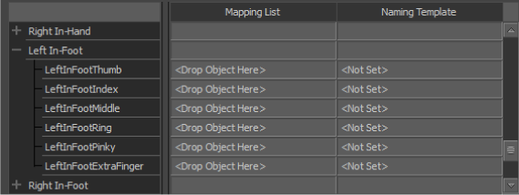

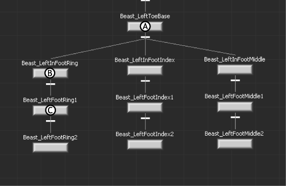

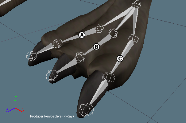

Left In-Foot group
Left In-Foot objects A. LeftInFootIndex B. LeftInFootMiddle C. LeftInFootRing
The Left In-Foot and Right In-Foot groups contain in-foot slots for each toe (named thumb, index, middle, ring, and pinky), as well as a slot for an extra toe. The naming of these slots is based on the Left In-Hand and Right In-Hand groups as these groups are similar. The LeftInFootThumb slot represents the big toe on the left foot, the LeftInFootIndex represents the second toe on the left foot, and so on.
Hierarchy of Left In-Foot objects A. LeftToeBase object B. LeftInFootRing object C. LeftFootRing1 object

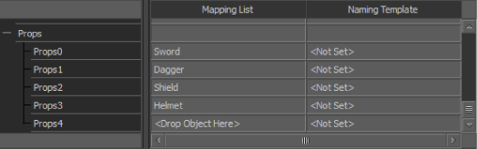

Props group
Lets you add the LeftShoulderExtra_Bone and the RightShoulderExtra_Bone asscoiated with your character.
