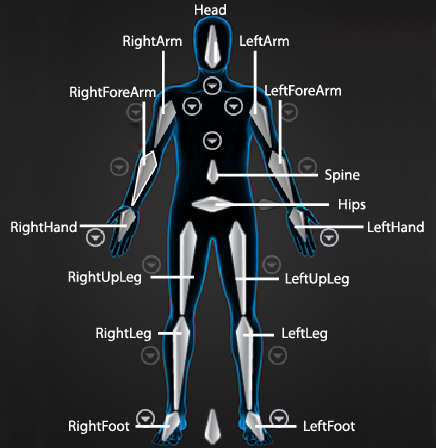

Required nodes
The fifteen nodes required by the HIK solver display in the full-body layout of the Character view, and are grouped together in the Required group of the Name Match view.
These required nodes identify the main joints in the skeleton of your character: its ankles, knees, hips, spine base, shoulders, elbows, wrists and head. Figuring out which bone in your skeleton map to each of these nodes is straightforward:
Node Maps to
Hips The bone that is the parent of spine and leg chains in your character.
LeftUpLeg and RightUpLeg The first bones in upper legs of your character.
LeftLeg and RightLeg The first bones in lower legs of your character.
LeftFoot and RightFoot The first bones that extend from ankles of your character into its feet.
Spine The first bone in the spine that is above the bone you map to the hips node. Represents the base of the spine.
LeftArm and RightArm The first bones in upper arms of your character.
LeftForeArm and RightForeArm The first bones in forearms of your character.
LeftHand and RightHand The first bones that extend from wrists of your character into its hands.
Head The last full bone in spine of your character, not the tip of the head, but the last full bone in the neck chain. This is typically the bone that controls the skinning of the head.
Note: Two optional nodes are also shown in the full-body layout: the Reference and HipsTranslation nodes. For details on these optional nodes, see Special nodes below.
