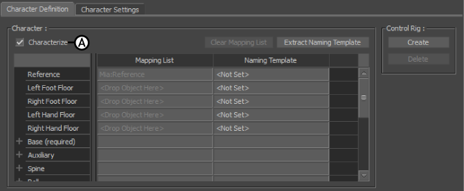

To characterize a character model:
- Complete the character mapping process, manually or automatically. See Character mapping.
- In the Navigator window > Character Settings > Character Definition pane, activate the Characterize option.
Character Definition pane A. Characterize option
Note: Activating the Characterize option updates and lock the character definition in the Character Controls window > Definition tab.
- A dialog box appears to remind you that your model must be in a stance facing the positive Z-axis. Choose between two types of postures for your character (Biped or Quadruped).
Once it is characterized, your character is ready to be attached to a motion source.
