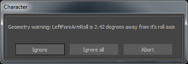

Depending on your model and the objects defined in the Mapping List, you may encounter errors when you attempt to characterize a character. You can ignore some of these errors, while other errors prevent your model from becoming characterized.
Roll axis warning

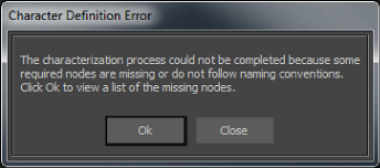

Character Definition error dialog box
You must define objects in all the slots of the Base group of the Mapping List before you can characterize the character. Click Ok in the Character Definition Error dialog box to view a list of required objects.

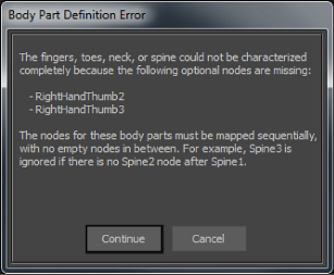

Body Part Definition error
For example, if a character’s spine is made up of three objects, those objects must be mapped to the Spine1, Spine2, and Spine3 slots. If the objects are mapped to Spine1, Spine3, and Spine4, the empty slot at Spine2 causes the objects in Spine3 and Spine4 to be ignored.
Because these slots are optional, you do not have to correct the problem to characterize your character. However, the affected body part may not react as expected when manipulated. Click Continue if you want to characterize your character anyway, or click Cancel to stop the operation and change the mapping.

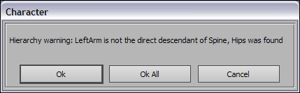

Hierarchy warning dialog box
