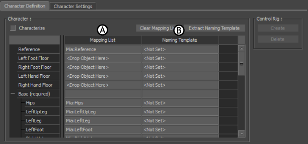

A. Mapping List B. Naming Template column
The Mapping List contains all the data that MotionBuilder needs to understand the structure of your character and how it can move. It contains the list of bone names that MotionBuilder understands.
For any skeleton that you introduce, MotionBuilder requires that you map a minimum of fifteen objects to the Base group of slots.
