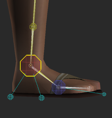

Three Auxiliary pivots display for two IK effectors in a character’s foot
As you set keyframes, you can switch between Auxiliary pivots, making the foot rotate around the ankle, the heel, the base of the toes, the tip of the toes, and even the sides of the foot. For more information on switching between pivots, see Setting a master Auxiliary pivot.

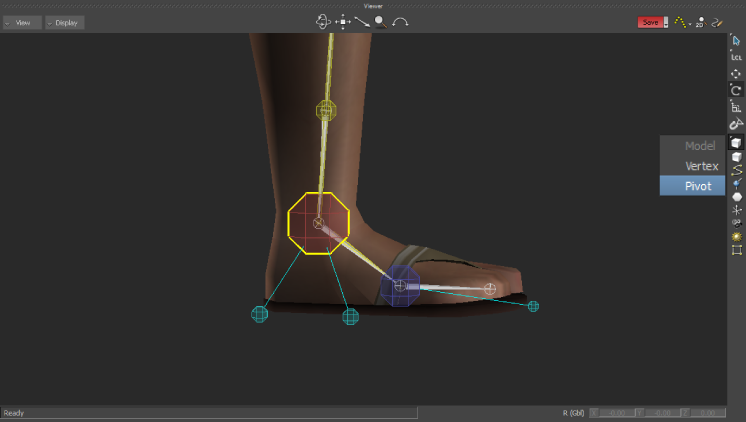

To manipulate Auxiliary pivots, select Pivot mode from the Selection Mode menu in the Viewer window. Pivot mode is automatically selected when you create a new Auxiliary pivot. You can then select and define offsets for the pivots by dragging them to new positions relative to the IK effector.
Viewer window A. Select Pivot from the Object Mode menu
