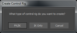

Control Rig. The Character dialog appears.
The Create Control Rig dialog appears.
FK/IK is the method commonly used to animate characters.
The Control rig is created and its effectors are shown on the character in the Viewer window.

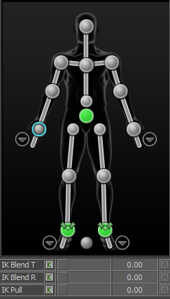

In the Character Controls window, the Control Rig settings are activated and include all the effectors you need to animate the Control rig.
The Character representation is an image of a human form meant to represent the biped skeleton.

), click the Full Body option (
). Setting the Control Rig to Full Body enables you to move the body using the entire Control rig.
Character representation Right Wrist effector selected
An effector that is selected is displayed with a blue (
) contour.
