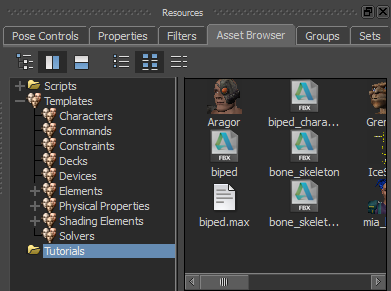

- In the Resources window Asset browser pane, click the Tutorials folder.
- In the Asset browser Display pane, locate the Pepe_rigged (Pepe_rigged.fbx) asset and drag the asset into the Viewer window and choose FBX Open

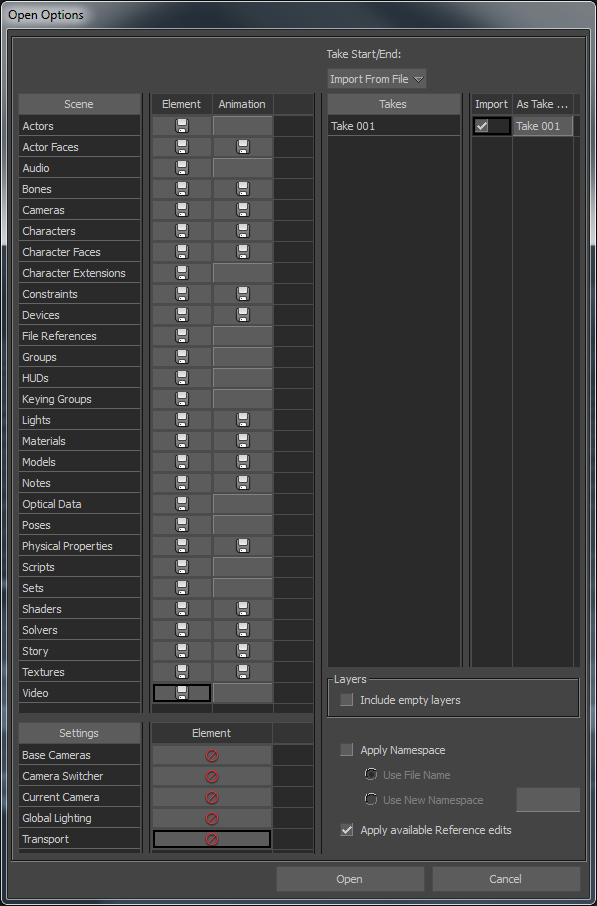

Options... from context menu.
The Open Options dialog appears displaying disabled camera settings.
Open Options dialog display disabled camera settings
- Click each camera setting to enable the settings.
- Click Open.

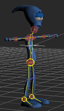

The characterized 3ds Max Pepe character loads in the Viewer window.
3ds Max characterized Pepe character

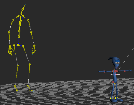

- In the Asset browser Display pane, locate the IceSlip (IceSlip.fbx) asset and drag the asset into the Viewer window and choose FBX Merge
IceSlip from the context menu.
A large yellow skeleton representing the motion capture animation now joins Pepe in the scene.
- In the Viewer window Camera View Navigation toolbar (
), drag the Zoom tool (
) or Ctrl-drag and zoom out until you can see the yellow skeleton.
Pepe with skeleton containing motion capture data

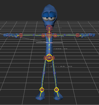

or press Ctrl-Home to go back to the beginning of the clip. In the Character Controls, notice the Source is set to ControlRig.
- Click the Source menu and select Skeleton2.
Skeleton2 is the name of the skeleton that contains the motion capture animation.
Pepe assumes the skeleton's stance, as shown in the following figure.

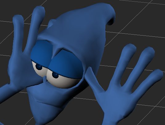

or Shift-drag). If you look carefully, Pepe’s hands pass though his face.
Unwanted hand movement from the motion capture
- Scrub the animation a few times if you cannot see the problem.
The animation that drives Pepe’s bone movement is based on a skeleton that has a very different physiology. For example, Pepe’s head, hands, and feet are much larger than the skeleton, while Pepe’s shoulders are much smaller than the skeleton’s shoulder.
