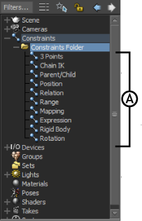

Scene browser A. Constraints folder
A new folder named “Constraints” appears in the Scene browser, with the new constraint added, and the Navigator window displays the Constraint settings.
