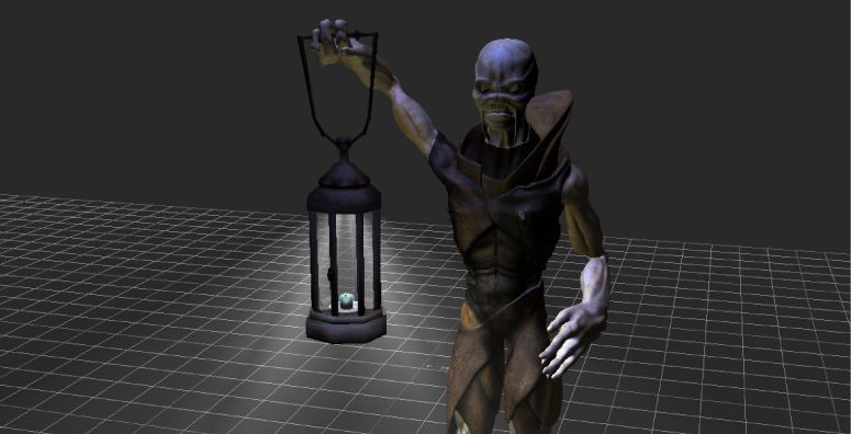

Constraints are tools used to create relationships between objects. You can use constraints to make a character pick up an object, have a camera follow a character, or use the keyboard or mouse to trigger events. For example, in the image below, a lantern is constrained to the character’s hand, so that however he moves his arm. the lantern follows.
The lantern is constrained to the character’s hand.
Another way to think of constraints is that they are a restriction of the translation, rotation, and other data of an object based on the position, translation, rotation, and other data of another object. So, in the image above, the transformation information of the character’s hand informs the behavior of the lantern.

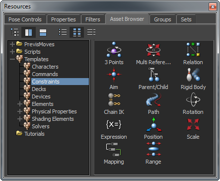

In the Asset browser, the Constraints folder lets view and access constraint assets you can add to your scene.
Asset browser: Constraints folder
