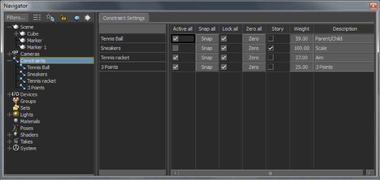

You can use the constraint root folder to Activate, Snap, Lock, Zero, View in Story, and set Weighting for multiple constrains at the same time.
The Constraints root folder is like a table of contents that lets you view constraints settings all at once, rather than opening each individual constraint.
To set commands in the constraints Root folder:
Constraints Root folder
