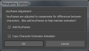

Retarget Rig
- Copies keyframe animation from the Control rig of the character selected as the Source to the Control rig of the current character. Selecting this option displays the Retargeting Options dialog box. The options in this dialog box lets you decide whether you want to allow added keyframes during retargeting, and whether you want to copy the Character Extension animation.
Turning on the
Add Keyframes option is recommended, if you are concerned with retargeting your original animation as precisely as possible. While the retargeting process copies animation nearly exactly, slight adjustments to the data are required to compensate for differences between the source and target characters. If you can tolerate these slight changes and you do not want any added keyframes, then disable the
Add Keyframes option.
