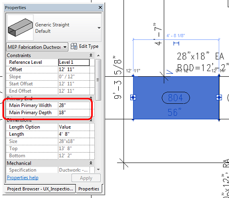

  2. In the Properties palette, type the new size value into one of the following fields:
    • Primary End fields: Main Primary Width, Depth, or Diameter
      The example below shows a run of round ductwork selected. In the Properties palette, the Main Primary Diameter field is changed from 12" to 8".
    • Product Entry: For Product-listed parts, such as pipework parts, select the new size from the Product Entry definition in the Properties palette.
