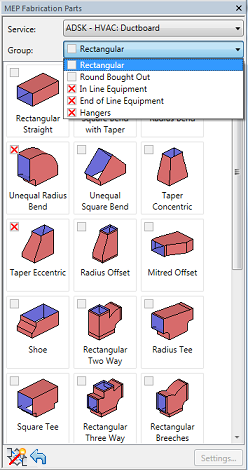

  2. Click the Auto Fill Exclusions Mode button located at the bottom of the MEP Fabrication Parts palette. Clicking this button turns on the auto fill tool exclusions mode, and adds a small empty check box next to each part displayed in the palette. A check box is also added next to each Service Group name displayed in the Group drop-down list, as shown below.

    • To exclude individual parts: Click the small check box next to a part to exclude that part from being used with auto fill tools. The icon displays when the part is excluded. For example, in the example shown above, the following parts have been excluded: Unequal Radius Bend and Taper Eccentric.
    • To exclude an entire group of parts: Click the small check box next to the Service Group name in the Group selector drop-down list. The icon displays when the group is excluded. For example, in the example shown above, the following Service Groups have been excluded: In Line Equipment, End of Line Equipment, Hangers.
