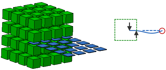

The issue here is related to the fact that the degrees of freedom for each part are different. Bricks have only the three translational degrees of freedom (Tx, Ty, and Tz) while plates (and shells) have all DOF except for rotation about the direction normal to the element. Therefore, the bricks cannot apply a moment to the plates to prevent the plates from rotating. Without special considerations, a connection between plates and bricks along a straight line of nodes will result in a hinge. This is depicted in Figure 1. In the case of linear static stress, hinge connections frequently result in a model that is not statically stable, though the example pictured below is stable due to the constraint at the opposite end of the plate.
Figure 1 Hinged Combination of Bricks and Plates
The black arrows represent the hinge line. The schematic on the right shows a side view and how the plate deflects; note the rotation at the hinge line. If the free end of the plate was not supported, the plates is free to rotate around the hinge line which would result in a statically unstable configuration.

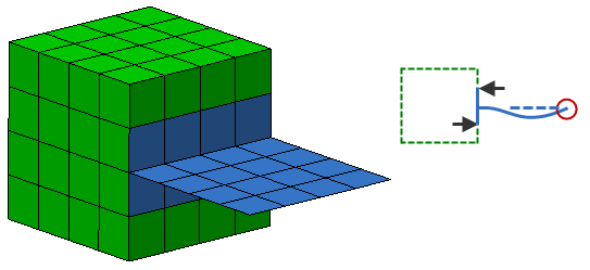

To avoid this hinge effect, the bonded contact between the plate and brick needs to be distributed over an area; specifically, at least three nodes not in a straight line. See Figure 2.
Figure 2 Statically Stable Combination of Bricks and Plates
In the top method, the plate is embedded one element deep into the bricks. (The elements are shrunk to show the space between them.) This method is applicable to hand-built (structured mesh) models. In the bottom method, a tee connection of plates is created on the surface of the bricks. In the schematics on the right, which show the side view, the arrows represent the reactions at the brick/plate interface. (These are in fact the forces that are transmitted between the nodes of the bricks and plates.) Since force couples can resist moment loads, the plate is now statically stable.

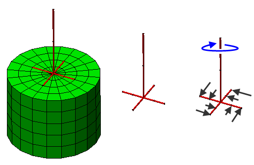

The connection between beams and bricks has a problem similar to the plate-to-brick connection: the bricks cannot prevent the beams from rotating. Beams support all six degrees of freedom (three translations and three rotations), but the bricks only support the three translational DOF (Tx, Ty, and Tz). The solution is likewise similar to plate/beam connections: make a web of beams (or spokes) to connect to the bricks. The beams must connect to the bricks at three or more points, not in a straight line, to form a statically stable solution. A beam attached to a brick at a single point acts like a ball joint, which typically results in statically unstable models. Figure 3 shows an example.
Figure 3 Statically Stable Combination of Bricks and Beams
The left side of the figure shows the beams and bricks together; the middle shows the beams only. Note how the vertical member is connected to four other beams that tie to the bricks at multiple points. If a torque were applied to the beams, such as in the schematic on the right side, then the black arrows represent the reactions provided by the bricks.
