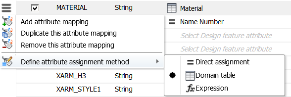

- In the Schema attribute list, for the first domain value attribute of interest, click Actions
Define Attribute Assignment Method

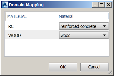

Domain Table.
- In the Domain Mapping dialog box, create the mapping between the source values and the target values.
