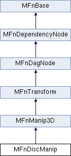

Inheritance diagram for MFnDiscManip:Public Member Functions | |

Public Member Functions inherited from MFnBase | |
| virtual | ~MFnBase () |
| Class Destructor. More... | |
| bool | hasObj (MFn::Type) const |
| Determines whether or not the Function Set is compatible with the specified Maya Object within the API RTTI system. More... | |
| bool | hasObj (const MObject &) const |
| MObject | object (MStatus *ReturnStatus=NULL) const |
| Returns the MObject that is attached to the Function Set. More... | |

Public Types inherited from MFnTransform | |
| enum | LimitType { kScaleMinX, kScaleMaxX, kScaleMinY, kScaleMaxY, kScaleMinZ, kScaleMaxZ, kShearMinXY, kShearMaxXY, kShearMinXZ, kShearMaxXZ, kShearMinYZ, kShearMaxYZ, kRotateMinX, kRotateMaxX, kRotateMinY, kRotateMaxY, kRotateMinZ, kRotateMaxZ, kTranslateMinX, kTranslateMaxX, kTranslateMinY, kTranslateMaxY, kTranslateMinZ, kTranslateMaxZ } |
| Limit types. More... | |
Public Types inherited from MFnDagNode | |
| enum | { kNextPos = 0xff } |
| Anonymous enum to store constant values. More... | |
| enum | MObjectColorType { kUseDefaultColor = 0, kUseIndexColor, kUseRGBColor } |
| Enum to set how an object is colored. More... | |
Public Types inherited from MFnDependencyNode | |
| enum | MAttrClass { kLocalDynamicAttr = 1, kNormalAttr, kExtensionAttr, kInvalidAttr } |
| Specifies the scope of the attribute. More... | |
| enum | MdgTimerState { kTimerOff, kTimerOn, kTimerUninitialized, kTimerInvalidState } |
| Possible states for the node's timer. More... | |
| enum | MdgTimerMetric { kTimerMetric_callback, kTimerMetric_compute, kTimerMetric_dirty, kTimerMetric_draw, kTimerMetric_fetch, kTimerMetric_callbackViaAPI, kTimerMetric_callbackNotViaAPI, kTimerMetric_computeDuringCallback, kTimerMetric_computeNotDuringCallback, kTimerMetrics } |
| The different timer metrics which can be queried. More... | |
| enum | MdgTimerType { kTimerType_self, kTimerType_inclusive, kTimerType_count, kTimerTypes } |
| The types of timers which can be queried. More... | |
