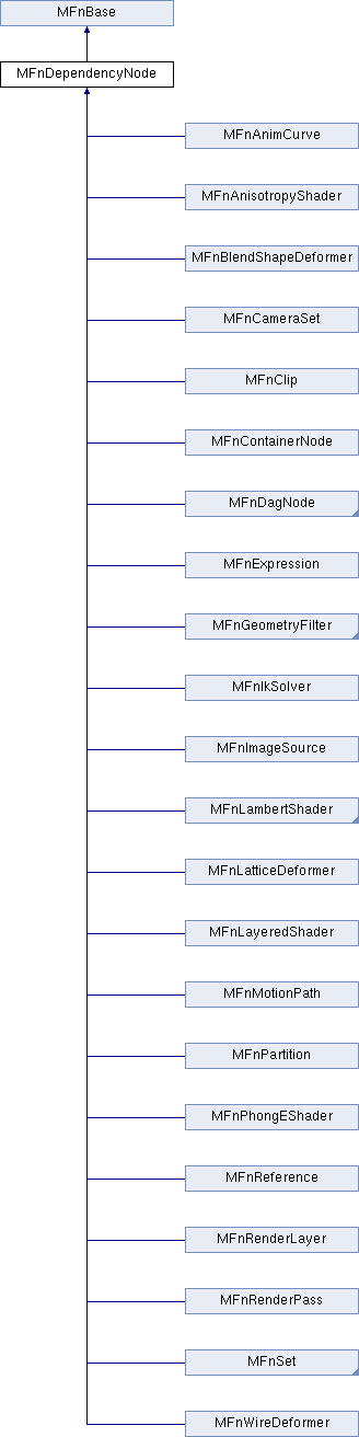

Inheritance diagram for MFnDependencyNode:Public Types | |

Reimplemented in MFnAnimCurve, MFnSubd, MFnMesh, MFnTransform, MFnNurbsSurface, MFnNurbsCurve, MFnAssembly, MFnClip, MFnCharacter, MFnBlendShapeDeformer, MFnParticleSystem, MFnDagNode, MFnIkJoint, MFnLatticeDeformer, MFnWeightGeometryFilter, MFnSet, MFnLattice, MFnCameraSet, MFnMotionPath, MFnRotateManip, MFnScaleManip, MFnSkinCluster, MFnToggleManip, MFnGeometryFilter, MFnDirectionManip, MFnFreePointTriadManip, MFnImageSource, MFnReference, MFnSpotLight, MFnStateManip, MFnWireDeformer, MFnCircleSweepManip, MFnCurveSegmentManip, MFnHikEffector, MFnPartition, MFnPointOnCurveManip, MFnPointOnSurfaceManip, MFnContainerNode, MFnDiscManip, MFnLayeredShader, MFnPhongEShader, MFnAnisotropyShader, MFnExpression, MFnFluid, MFnIkEffector, MFnIkSolver, MFnLambertShader, MFnManip3D, MFnReflectShader, MFnCamera, MFnDistanceManip, MFnDragField, MFnNewtonField, MFnNonAmbientLight, MFnNonExtendedLight, MFnRadialField, MFnRenderPass, MFnVortexField, MFnAmbientLight, MFnAreaLight, MFnDirectionalLight, MFnGravityField, MFnLight, MFnPointLight, MFnRenderLayer, MFnTurbulenceField, MFnUniformField, MFnVolumeAxisField, MFnVolumeLight, MFnAirField, MFnBlinnShader, MFnField, MFnIkHandle, MFnPhongShader, MFnInstancer, and MFnPfxGeometry.
