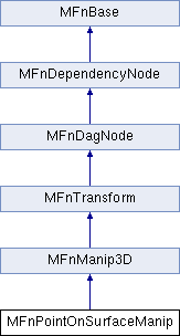

Inheritance diagram for MFnPointOnSurfaceManip:Public Member Functions | |
