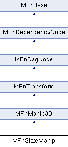

The StateManip allows the user to switch between multiple states. It is drawn as a circle with a notch. Each click on the circle increments the value of the state (modulo the maximum number of states). This manipulator generates an integer value corresponding to the state of the manip.
Examples:
Inheritance diagram for MFnStateManip:Public Member Functions | |
