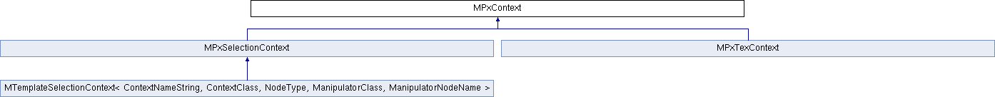

Inheritance diagram for MPxContext:Public Types | |
