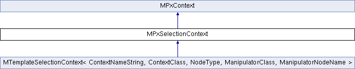

Inheritance diagram for MPxSelectionContext:Public Member Functions | |
