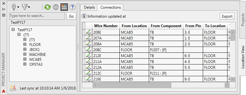

Details and Connections Pane (Location View Tab)
Displays the component details and wiring from\to information.
Find
 Command entry:  AEPROJECT
Select the Location View tab. Select the node or device in the tree you want to view the details or connections for. Select the top node to view the entire project. Click .
Details Pane
Displays component details.
Connections Pane
Displays wiring and connection information

Available Fields - Connections Pane
Each row in the grid can include two connected components, referred to as the From and To components. Whether a component is considered the From or the To component is based on the wire sequence for the wire network. The wire sequence can be defined specifically or can default to the Tag/Wire Number/Wire Sequence Order defined on the Drawing Format tab of the Drawing Properties dialog box.
  • Wire Number. The wire number assigned to the wire.
  • Wire Id. The identifier assigned to the wire in Inventor.
  • From Installation. The INST value on the From device.
  • From Location. The LOC value on the From device.
  • From Component. The tag value on the From device.
  • From Pin. The pin value on the From device the wire is connected to.
  • To Installation. The INST value on the To device.
  • To Location. The LOC value on the To device.
  • To Component. The tag value on the To device.
  • To Pin. The pin value on the To device the wire is connected to.
  • Cable Installation. The INST value on the cable marker on the wire.
  • Cable Location. The LOC value on the cable marker on the wire.
  • Wire Type. The wire type for the wire as defined in the Create/Edit Wire Type dialog box.
  • Wire Color. The wire color for the wire as defined in the Create/Edit Wire Type dialog box.
  • Wire Gauge. The wire size for the wire as defined in the Create/Edit Wire Type dialog box.
  • Cable. The tag value on the cable marker on the wire.
  • Wire Length. The wire length as defined in Inventor.
