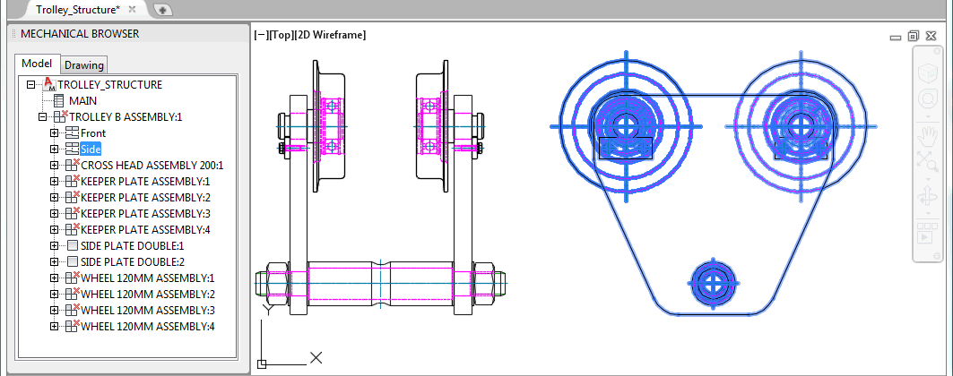

Example
In this example, the assembly, TROLLEY, has two views that are shown in model space and the mechanical browser. The view that is selected in the mechanical browser is highlighted in model space.
