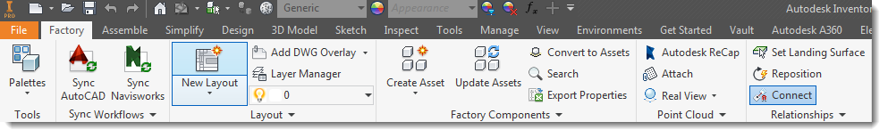

    Use the Connect command to manually connect connection points that are near each other.
    Place assets with multiple connectors and then select the Connect command.
    Select the first connector on the asset.
    Drag and drop the first connector to connect the second connector.
    Finally, the asset is constrained by connectors.
