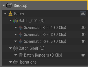

Desktop
Organizes the project into two distinct working areas: Batch FX groups and Reel groups.
Batch Iteration
The second level of the Batch structure, containing the schematic reels. The name of the current iteration is displayed and the number of reels is shown in parenthesis. Schematic reels may be added or deleted, and renamed or colour-coded.
Batch Shelf
Organizes media on reels outside of Batch iterations. Includes the Batch Renders reel and the Shelf reel. The number of reels is shown in parenthesis. Shelf reels may be added or deleted, and renamed or colour-coded.
Iterations
Stores Batch iterations. This folder may be shown or hidden depending on the Workspace preferences. For more information, see Saving Work using Batch or Batch FX Iterations.
