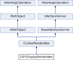

+ Inheritance diagram for IGPUDisplayRenderItem:
