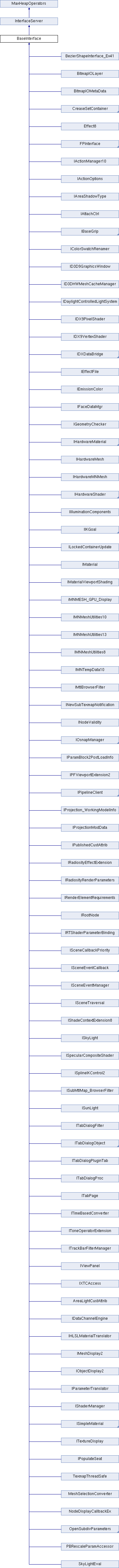

This class represents the base class for interfaces in 3ds Max. The BaseInterface class should be used as the base class for any new interface class in 3ds Max and provides basic identity, memory management, and cloning methods. Class FPInterface, which is part of the Function Publishing system, has the BaseInterface class as its base class.
+ Inheritance diagram for BaseInterface:
