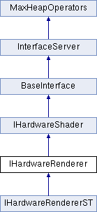

+ Inheritance diagram for IHardwareRenderer:
