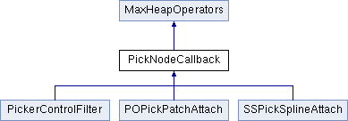

Description:
This class is used to filter nodes during a hit test. See the methods Interface::PickNode(). and PickModeCallback::GetFilter().

virtual BOOL Filter ( INode node)
pure virtual
Remarks
This method should return TRUE if the node passed is an acceptable hit and FALSE otherwise.
Parameters:
INode *node
The node to test.
Returns
Return TRUE if this is an acceptable hit, FALSE otherwise.
Implemented in SSPickSplineAttach, PickerControlFilter, and POPickPatchAttach.
