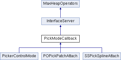

+ Inheritance diagram for PickModeCallback:

Implemented in SSPickSplineAttach, PickerControlMode, and POPickPatchAttach.

Reimplemented in SSPickSplineAttach, PickerControlMode, and POPickPatchAttach.

Reimplemented in SSPickSplineAttach, and POPickPatchAttach.
