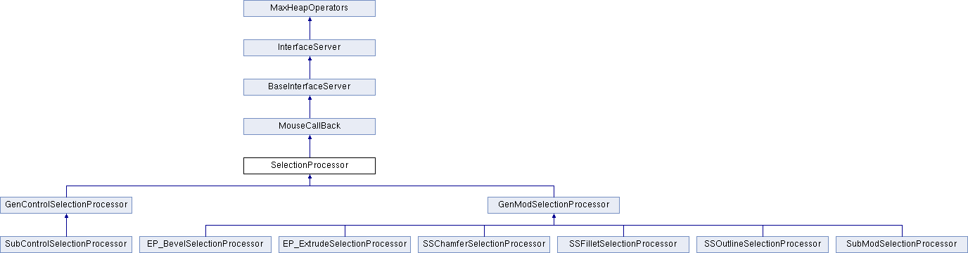

+ Inheritance diagram for SelectionProcessor:
