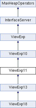

Class Description
Extends ViewExp10.
The following code example shows how to get access to this interface:
// hWnd is the handle of a viewport window. This is passed to MouseCallback::proc
ViewExp& vp = ip->GetViewExp(hWnd);
ViewExp11* vp11 = NULL;
if (vp.IsAlive())
vp11 = reinterpret_cast<ViewExp11*>(vp.Execute(ViewExp::kEXECUTE_GET_VIEWEXP_11));
+ Inheritance diagram for ViewExp11:
