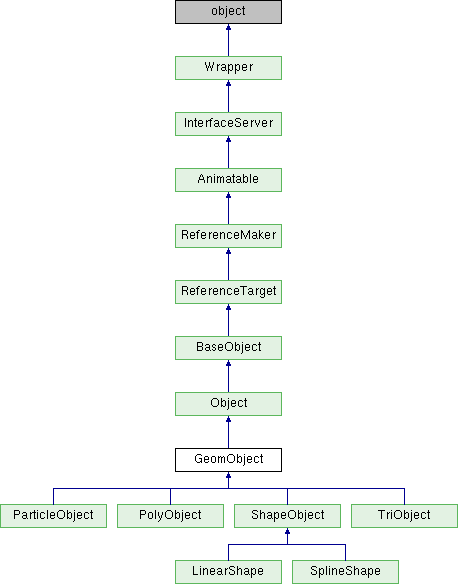

GeomObject Class Reference
Class Description
An object with geometry that can be rendered.
+ Inheritance diagram for GeomObject:
